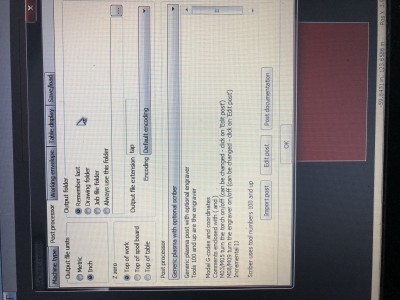

tkton123
Posts: 16
Joined: Mon Aug 05, 2019 7:15 am
Re: SheetCam Tool Parameters
Post by tkton123 » Sun Feb 02, 2020 6:51 am
Dave56 wrote: Sat Feb 01, 2020 2:33 am WHO HAS FIGURED OUT HOW TO USE SHEETCAM WITH GOFAB TABLES?? WANTING TO USE MY SHEETCAM..JUST DONT KNOW HOW TO SET IT UP..THANKS :!:
I have used it since the beginning, since it allows me to select the pierce points were i want.
just select the Generic Plasma With Optional scriber Post procesor.
