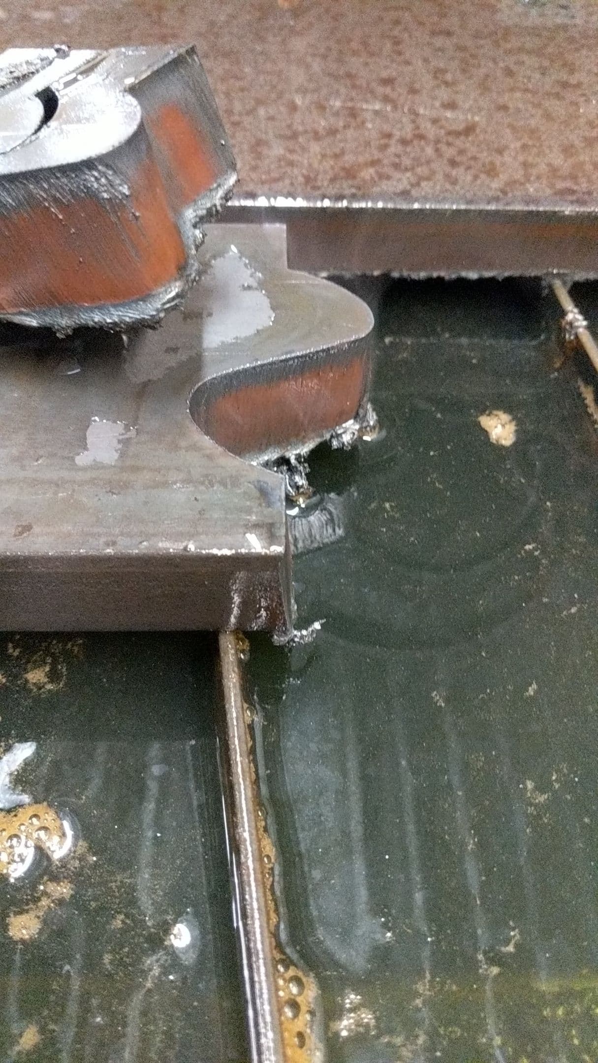

Post by chademling94 » Thu Apr 16, 2020 12:11 am
70 amps, feed-150, ignite- 110, plunge-90, cut-105, delay 1500 and 75 psi with a 1.2 tip. EDGE START ONLY!! Got some dross on the bottom but the cut is almost perfect and no kerf

WOW ! Good to know..I take it was cut with the new software? Im getting ready to cut some 1 inch for a guy mini Pulling Tractor Weights. So Ill have to try it out. but your Feed Rate was 150?? That sounded kinda fast..Let me know... Thanks for Post.

This is with the old software so that 150 feed is actually mmpm, convert to ipm (divided by 25.4) it would be just under 6 ipm.
