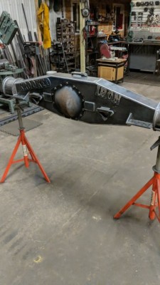

This is the main reason i bought a plasma table to build these. They start out at corp 14bolt full floaters and get all braced up to run in demolition derby cars all around the US!

Before paint

Kickass! I'm toying with doing my first LS swap and serious suspension overhaul on a desert racer. What kind of steel would you recommend for shock tabs and motor mounts? I've got A36 and AR500 drops for days, but something tells me that won't fly. Rollcage is half done, but wanted to build out the suspension and motor before caging everything in.

All I use is A36 and havnt had any issues with it and i have a few buddies that build/run rock crawlers and that is all they use. Ive debated using AR but its just not worth it to me. Of course in these situations we are overbuilding so there is no chance of breaking but i think A36 would me fine (overbuild is underrated)

That’s some beef right there. Nice work
