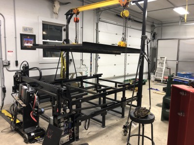

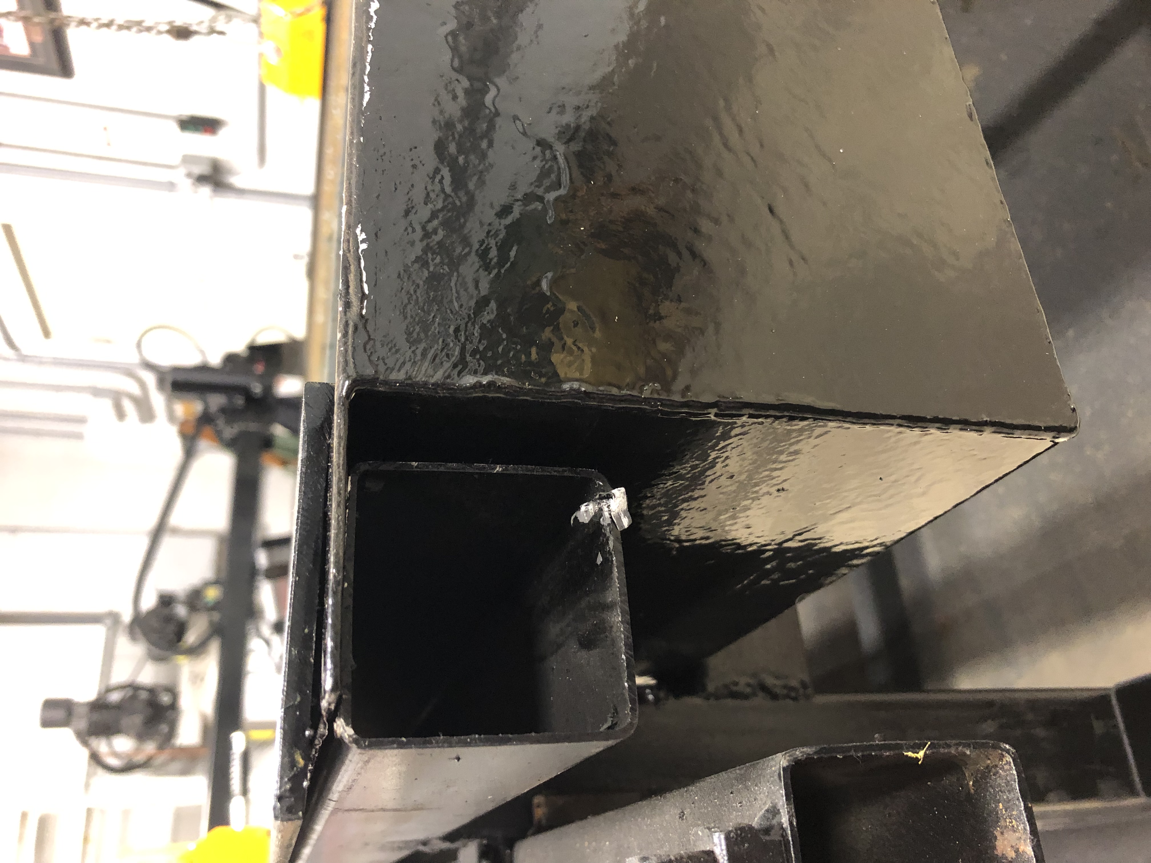

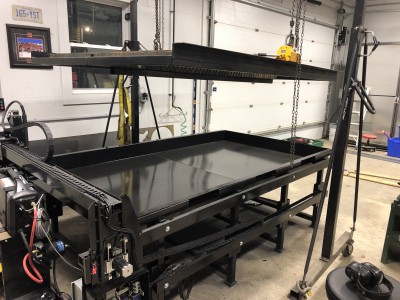

Did mine pretty much the same way but hemmed the ends and bent the metal at the sides to rest on the bottom structure and ‘sandwich ‘ it between the structure and the table.[/attachment] [attachment=1]F617368E-25B8-47BD-A1C9-0275A37D2E87.jpeg

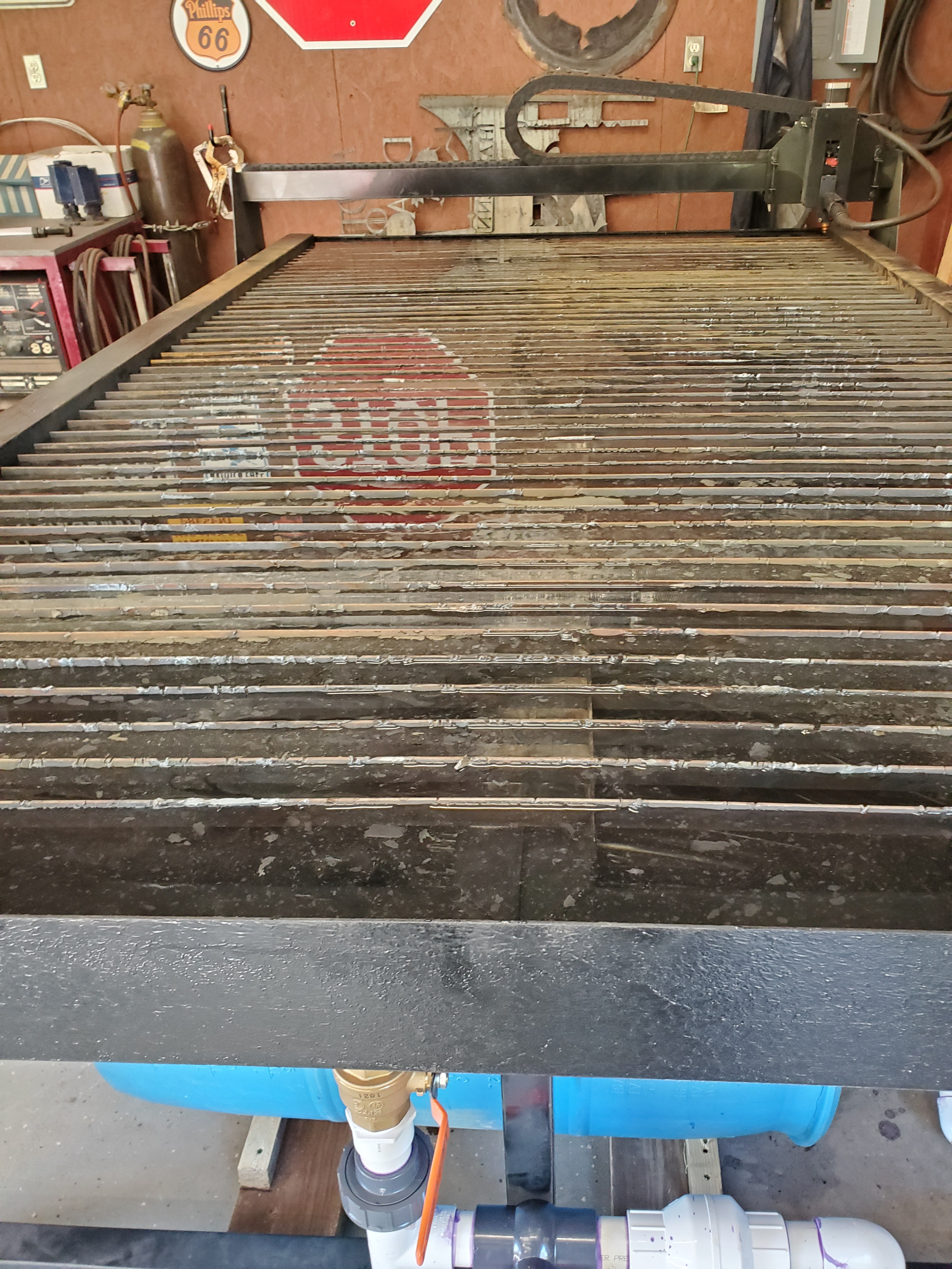

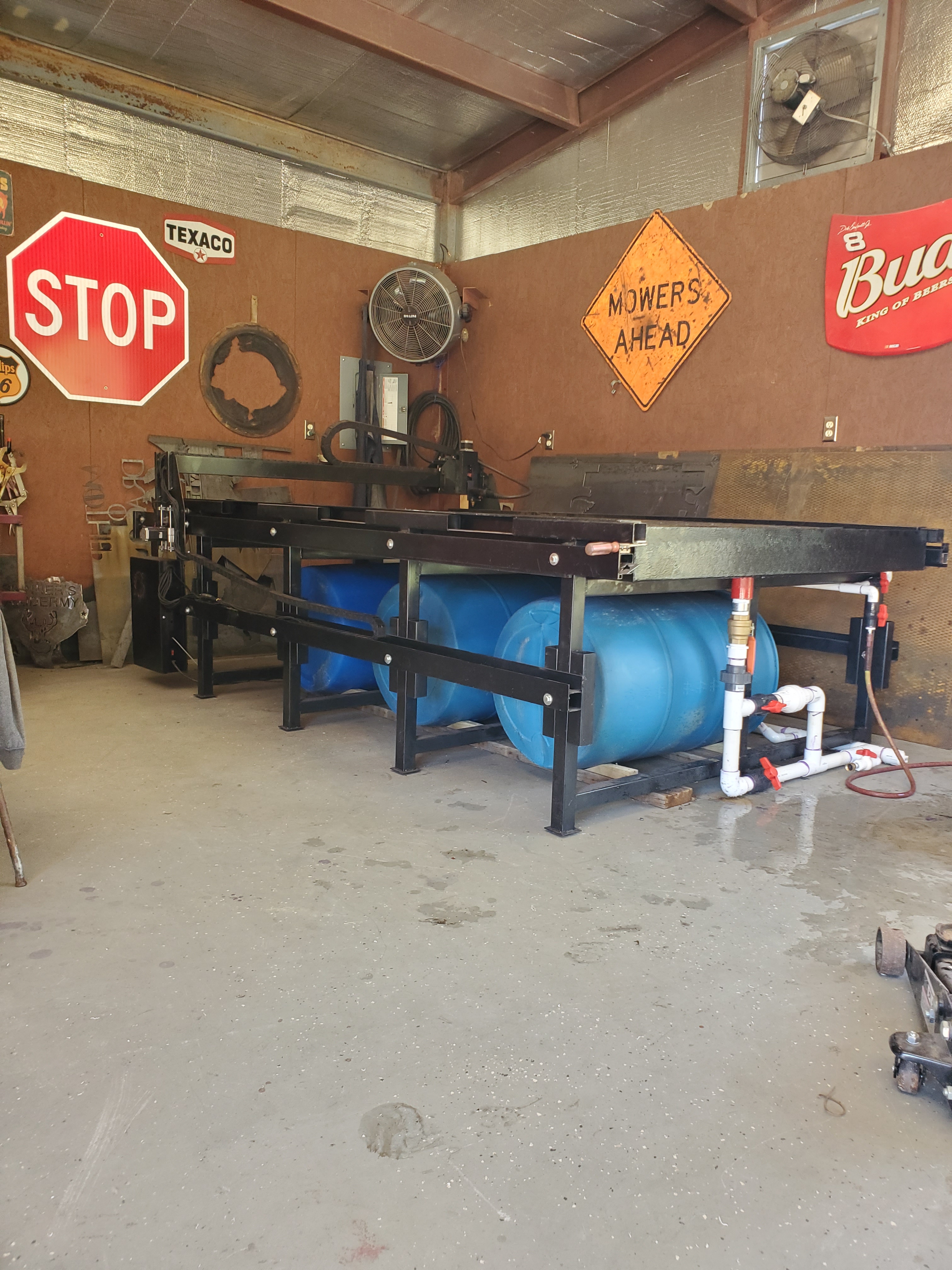

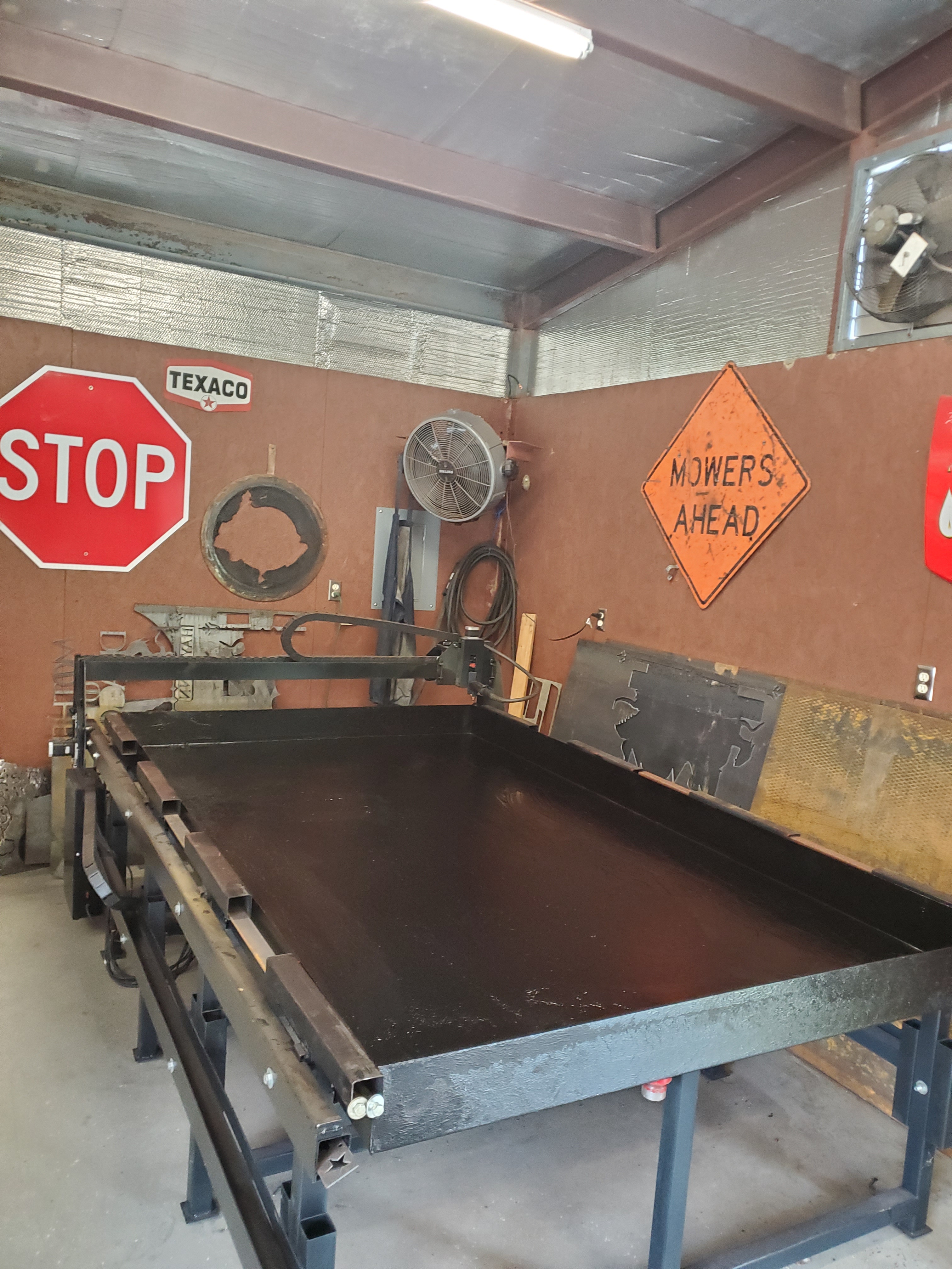

I finally finished my water pan. I couldn't deal with the dust any longer. I still haven't decided what additive that i will add to the water to prevent rust.
