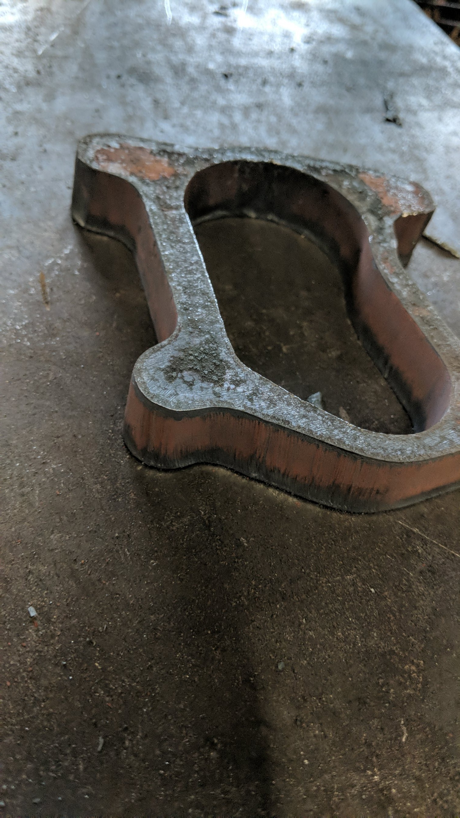

3/4"
3/4"
Pierces didn't go so hot (actually to hot
) but edge start worked good! I drilled a hole for the center pierce.
Re: 3/4"
Yes 80 amp everlast. Cut at 65 amps and 175 feedrate
Re: 3/4"
The way the torch is clamped is the issue. If you look in the Tips and Tricks section under (Cuts look jagged or sawtooth like) Bdspindles made a fantastic looking clamp which i think is the direction i am going to go. But yes anything over like 400mmpm i get a crazy torch jitter on sudden direction changes.
