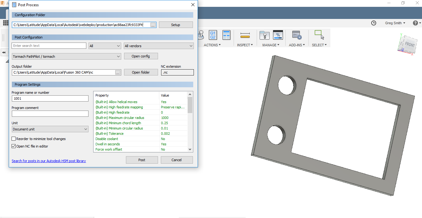

I've tried simple rectangles and holes so far with it and simply can't find a gcode to work with it. If anyone knows how to do the post processing/gcode for Fusion360, please share.

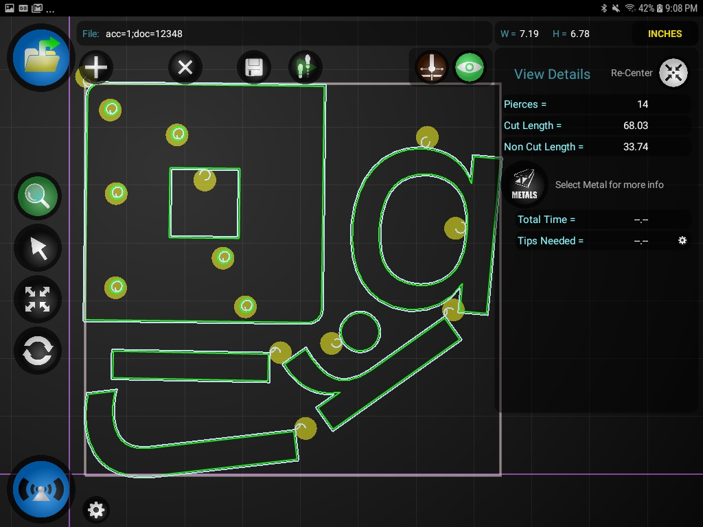

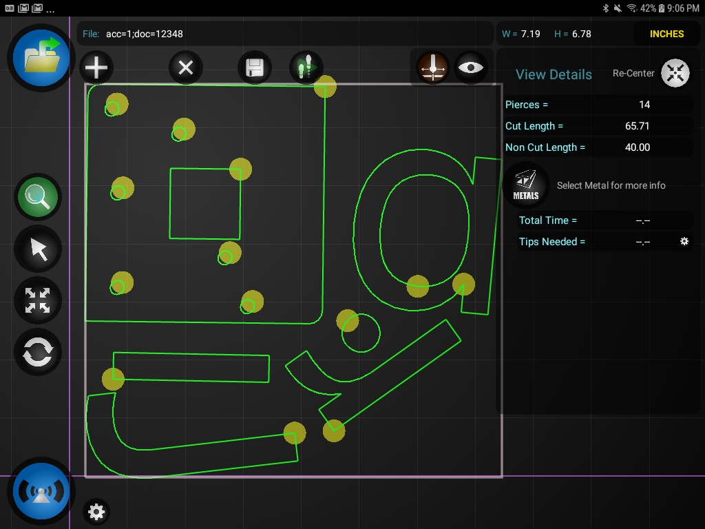

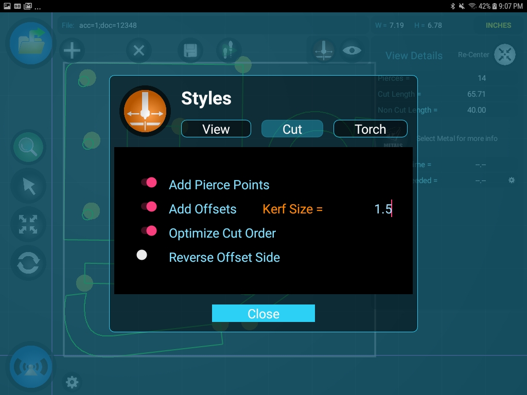

Also, the cut styles on the tablet has an "add pierce points" option that does what you want with offsets and pierce points when it isn't bugged (current release it's not working, but a fix is on the way), but it defaults the "arc in" length to 3x the cut width and arc out to 1.5x the cut width and automatically shortens the arc length for small inside holes. Would you want to be able to specify arc in and arc out? It also automatically detects inside edge and outside edge and sorts cuts by part and by distance (cuts all the inside holes on a part then cuts the outer cut of the part, then moves to the next closest part), and "Reverse Offset Side" is useful if you want to cut holes into an existing part. It's mostly to deal with random stuff that comes out of Inkscape so it ignores the start/stop points and handedness of the cut on incoming gcode and moves the starting pierce point to wherever the best place for an arc-in is. It's not perfect. Sometimes it puts pierce points on the wrong side and sometimes it gets the inside vs outside cut wrong, so you have to check the results. 90% of the time when it gets it wrong, you can rotate the pattern a little and it will get it right. Still trying to figure that one out.
When it works it looks like the attached snapshots.

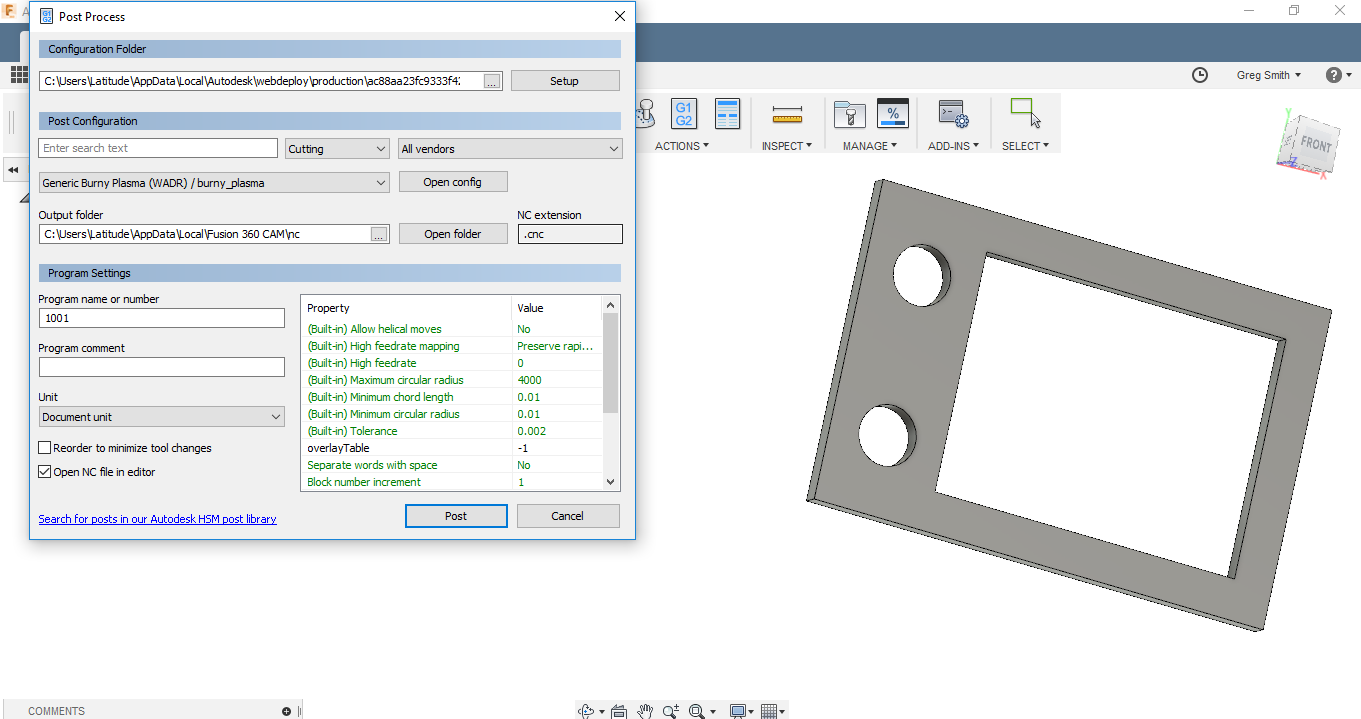

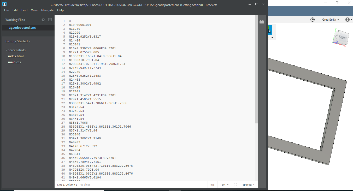

Here's the actual gcode that fusion 360 spat out when selecting the "Generic Burny Plasma" option from the drop down menu in F360. The screenshots from F360 are listed below also.

I checked out that gcode on the tablet and on ncviewer.com and saw pretty much the same thing -- a bunch of circles -- so the problem isn't on the tablet. I know folks use Fusion 360 with GoFab tables, but I don't know what their process is, and I'm a Fusion 360 noob, but my guess would be to try a different post configuration.
