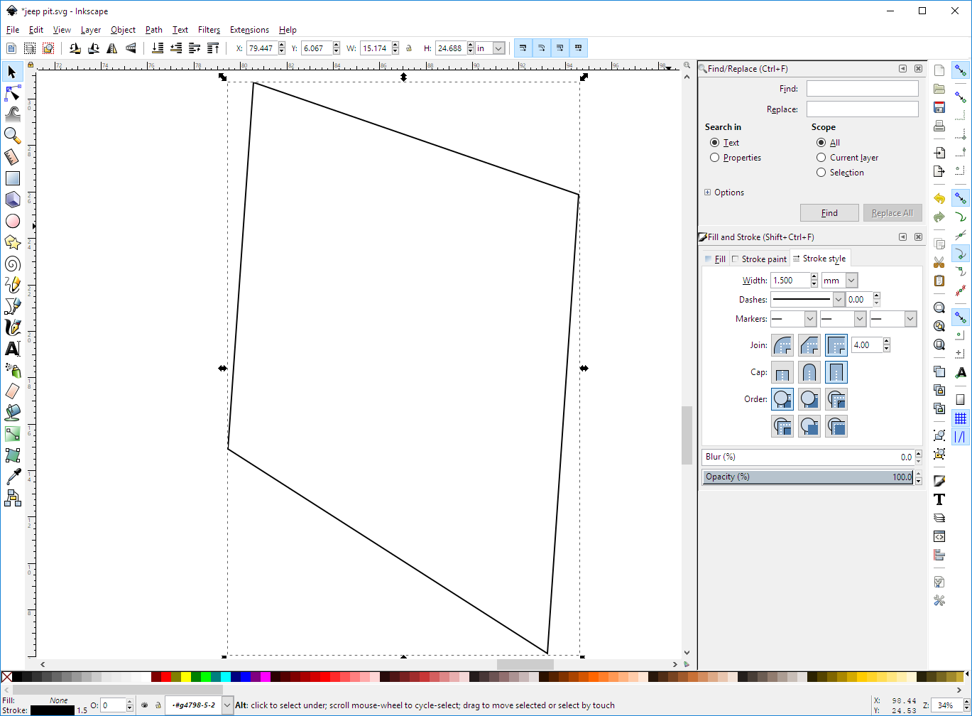

I don't know about fixing it in F360 but I get DXF files like that all the time.
I fix it in Inkscape using the paint bucket tool:
1. Select all the lines you want cut out
2. Go to Object->Fill and Stroke
3. On the "Stroke Style" tab, set the width to your kerf width.
4. On the "Stroke Style" tab, set the cap to square cap.
5. Select the paint bucket tool.
6. Zoom in as far as you can -- the paint bucket tool works in pixels so the more pixels covered by the part you want cut out, the less error there will be
7. Click in the middle of the part.
You should end up with a paint bucket fill of the part to be cut out. Export that paint bucket fill as gcode. On the tablet, make sure you turn off offsets (they were already applied by the line thickness in Inkscape), but you can still use pierce points.
Attached are before/after paint bucket fill in Inkscape and the Stroke style tab.

Dave,
How do I get pictures like this on here? I'd like to be able to share some visual aids that go along with the issue so others can understand better.

Post by Dave » Sun Dec 16, 2018 3:36 am
thebuilder wrote:
Sat Dec 15, 2018 10:53 pm
Dave,
In windows, you can copy and paste the app window into paint, save it as an image (png compresses best for typical applications), and add it as an attachment:
1. Give the window you want to save focus.
2. Press Alt+PrintScreen to copy the window to the clipboard
3. Open Paint
4. Click Paste.
5. Crop if needed.
6. Save as a png.
7. In the forum, underneath the main "Post a Reply" text box, click on the "Attachments" tab (see attached image :lol: ).
8. Click "Add Files" and select the image.
