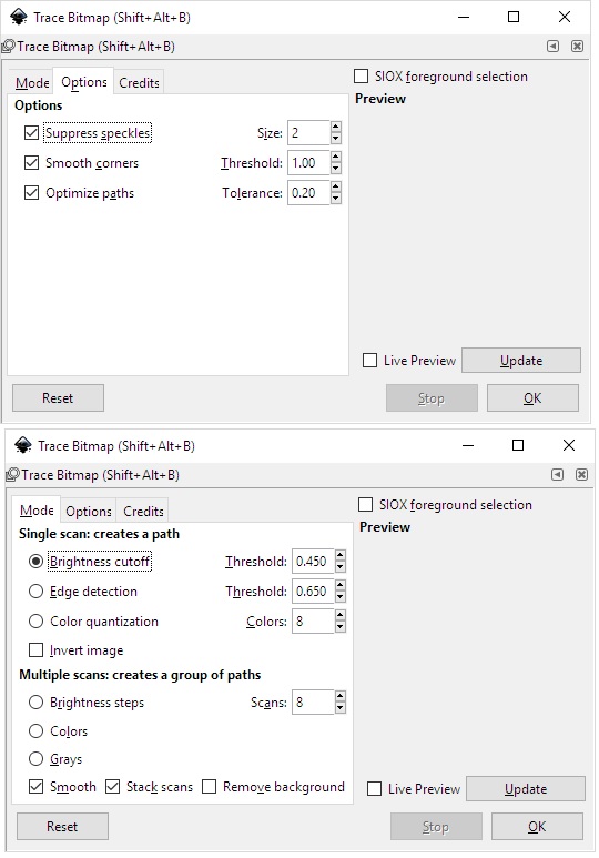

Here are my current trace bitmap settings. I adjust brightness cutoff depending on what I'm tracing, but usually keep it around 0.5 for tracing black and white silhouette images.
Sometimes if the image coming in is low resolution or very grainy, there's nothing that can be done but to manually touch it up by using the "edit paths by nodes" tool (just below the selection tool in the top left). Select that tool, then select the shape you want to clean up and it should show a bunch of squares that are the vector control points. You can select and move/delete individual points and push the shape around. You can use the buttons running along the top of the window to add new control points, turn lines into curves, etc.
