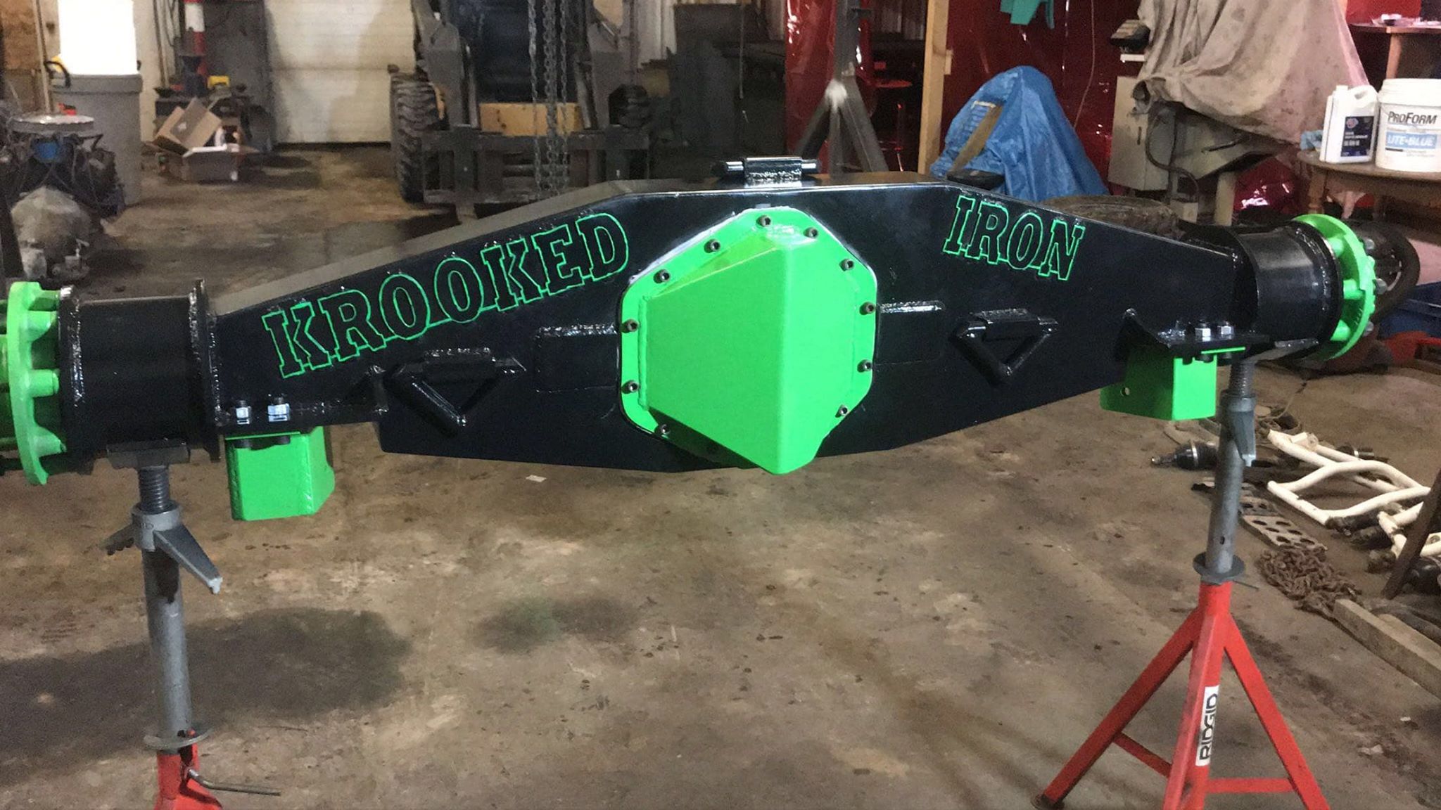

Post by chademling94 » Thu Apr 18, 2019 3:05 pm
This is the main reason i bought a plasma table to build these. They start out at corp 14bolt full floaters and get all braced up to run in demolition derby cars all around the US!

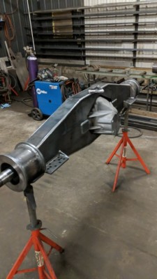

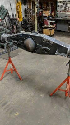

Post by chademling94 » Mon Apr 22, 2019 11:05 pm
Before paint
