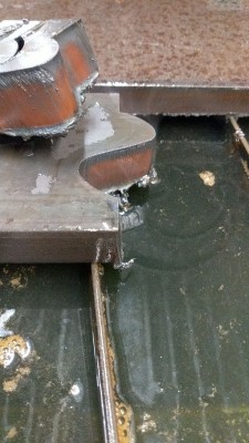

First 1" plate cut MINTYYY
- Posts: 138
70 amps, feed-150, ignite- 110, plunge-90, cut-105, delay 1500 and 75 psi with a 1.2 tip. EDGE START ONLY!! Got some dross on the bottom but the cut is almost perfect and no kerf
Re: First 1" plate cut MINTYYY
WOW ! Good to know..I take it was cut with the new software? Im getting ready to cut some 1 inch for a guy mini Pulling Tractor Weights. So Ill have to try it out. but your Feed Rate was 150?? That sounded kinda fast..Let me know... Thanks for Post.
- Posts: 138
This is with the old software so that 150 feed is actually mmpm, convert to ipm (divided by 25.4) it would be just under 6 ipm.
