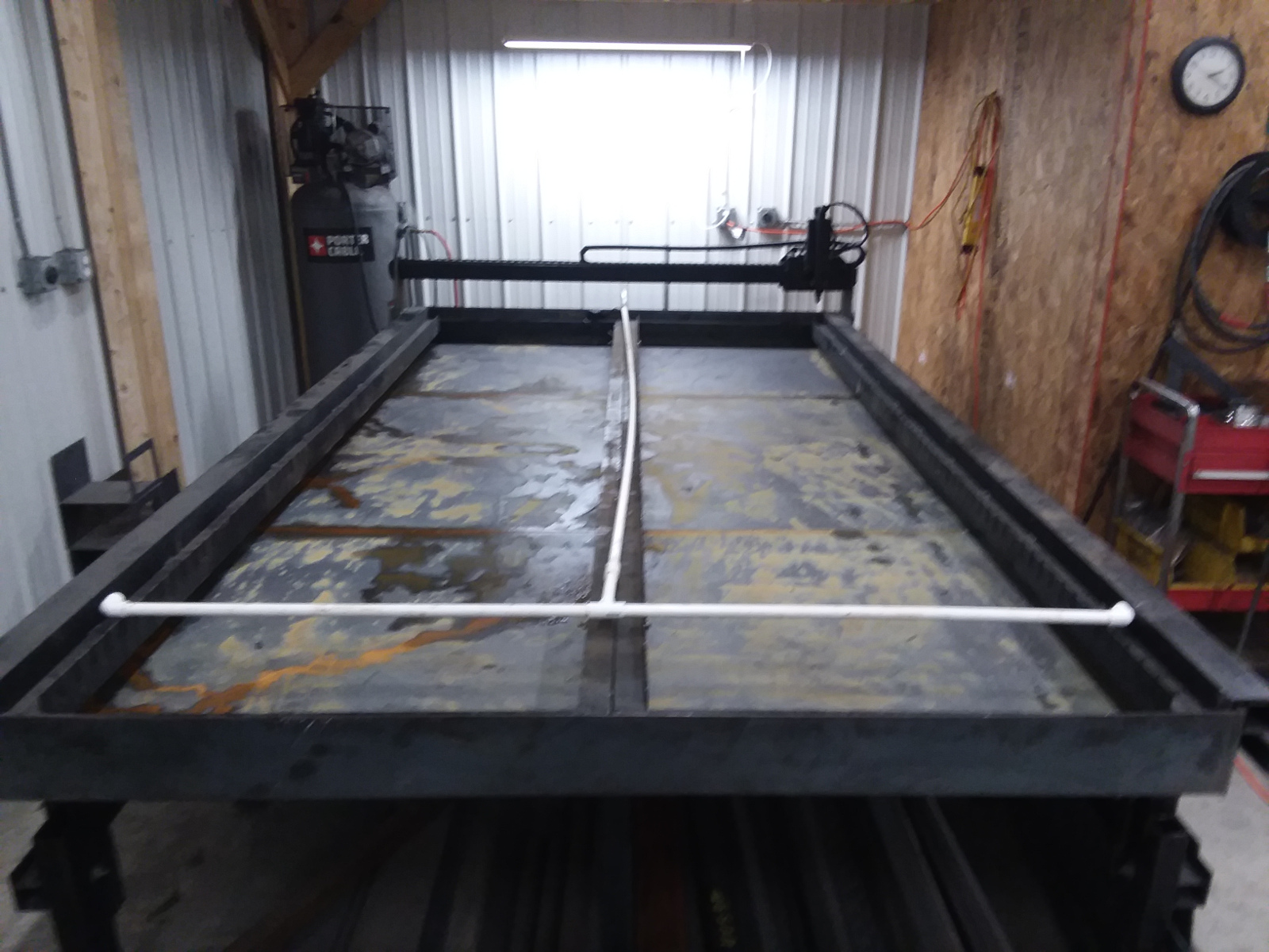

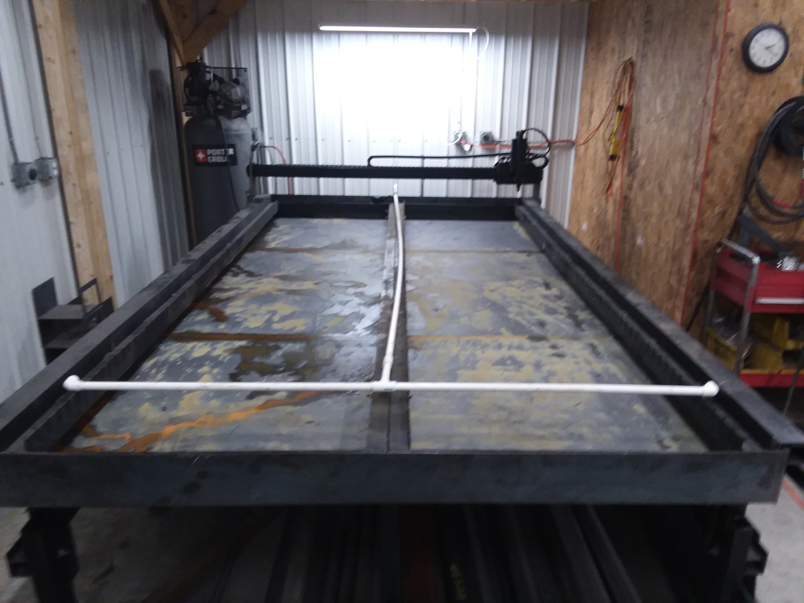

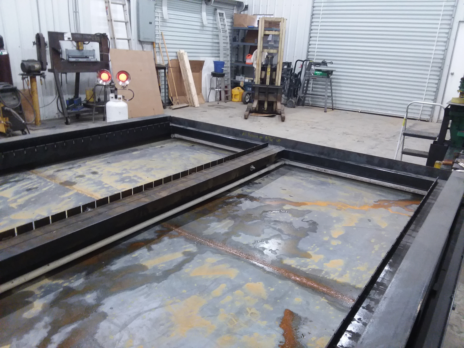

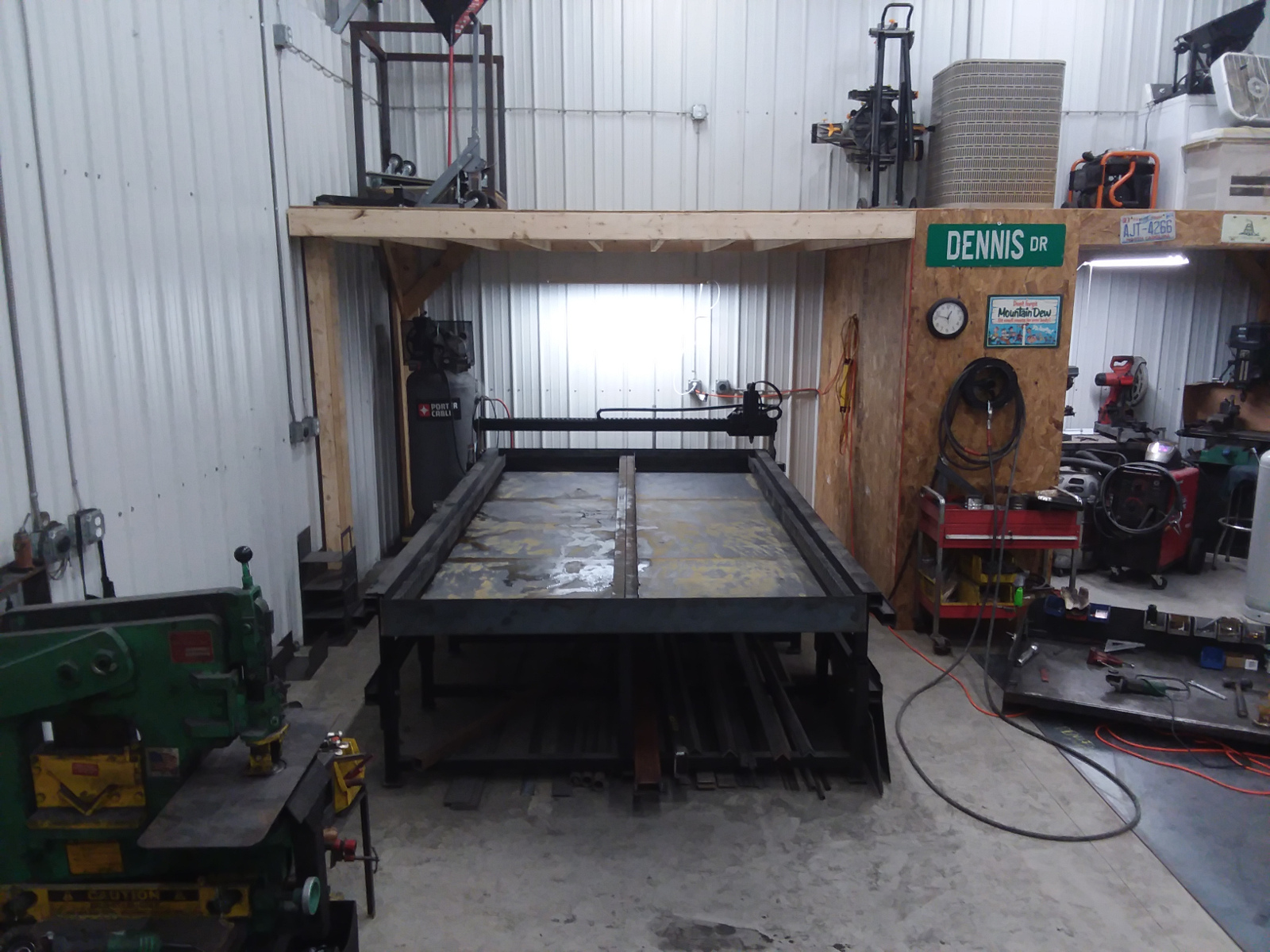

Re: Water Pans?
Circulation system (Big thanks to Dave!)...
Below is a repost of Dave's solution for fluid circulation.
https://drive.google.com/file/d/1nzgKAs ... 3uSwc/view

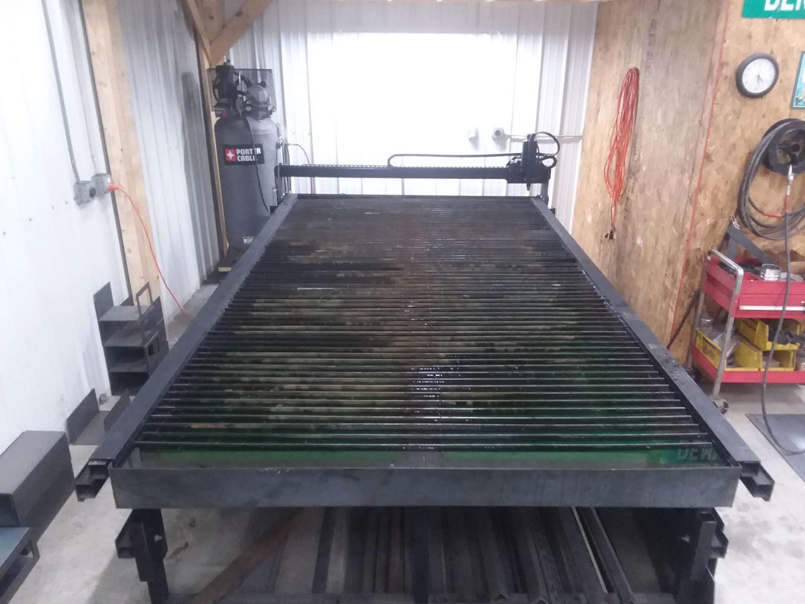

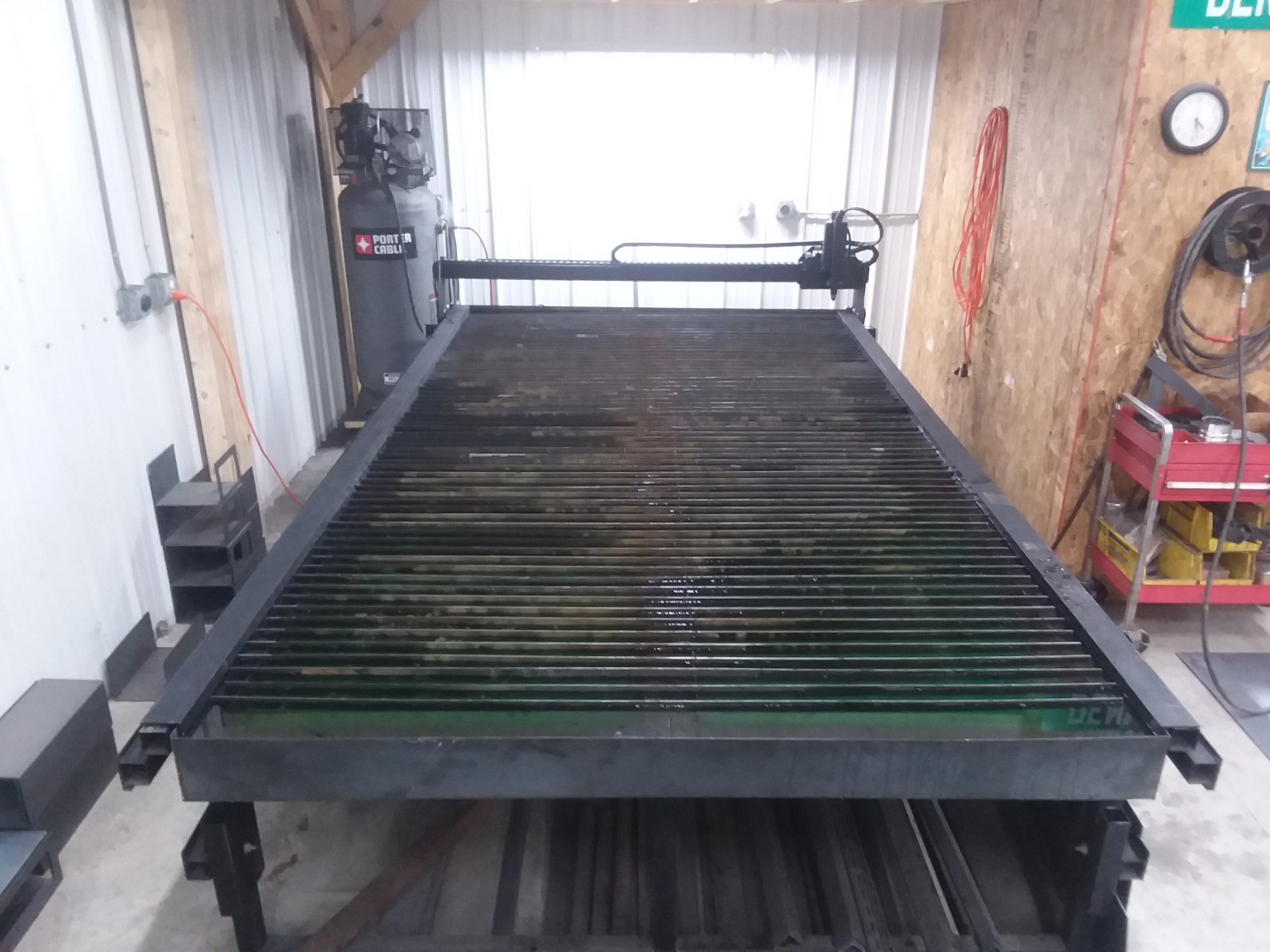

Re: Water Pans?
Filled up with 230 gallons and ready to cut...
Table solution (per 75 gallons)
1/4lb Sodium Nitrite
1 Teaspoon Physan 20
1oz. Green Food Dye
1oz. Green Food Dye
Dennis Meyers
www.diamondbackironworks.com
