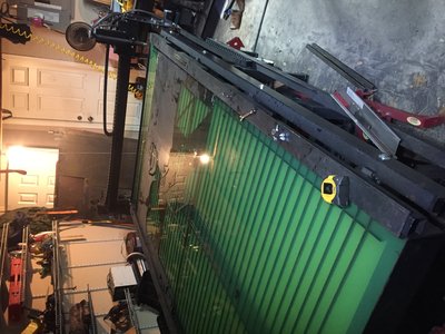

Here’s a pic of Go Fab CNC Table with a Water Pan and GreenCut.
We’ve never made a Water Pan for a 5’x10’ Table like yours, but you could make one similar to the way we do pans on the 4’x8’.
Since it rests on the crossmembers of the legs, it doesn’t need to be too terribly strong. We use 14 Guage steel for the pan and it works great.
There’s a product called GreenCut that’s designed for Plasma Water Pans that is supposed to inhibit rusting. I read somewhere you can use Antifreeze also since it’s designed to inhibit rust as well.
It might be a challenge acquiring a single sheet of steel large enough to make the entire pan. You may need to make 2 halves and weld the seam.
Keep us posted on your progress!
Call if we can help with anything.

Re: Water Pans?
That's my table!
GreenCut acts as a rust inhibitor. From the SDS it's just Propylene Glycol, which is used all over the place (food safe anti-freeze, vape juice, etc). I'm building out my circulation and filtration system now, will post pics as it comes. I just picked up a bunch of 55 gallon drums from Round Rock Honey so I can drain the table for cleaning. They're practically giving them away.

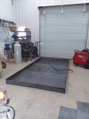

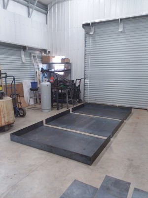

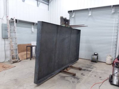

Re: Water Pans?
Water table build...
Table dimensions, 71 3/4" wide x 140" long x 5 3/4" deep.
12 gauge hot rolled mild steel.
Built in 3 sections. 2 welded seams and 4 corner welds.
