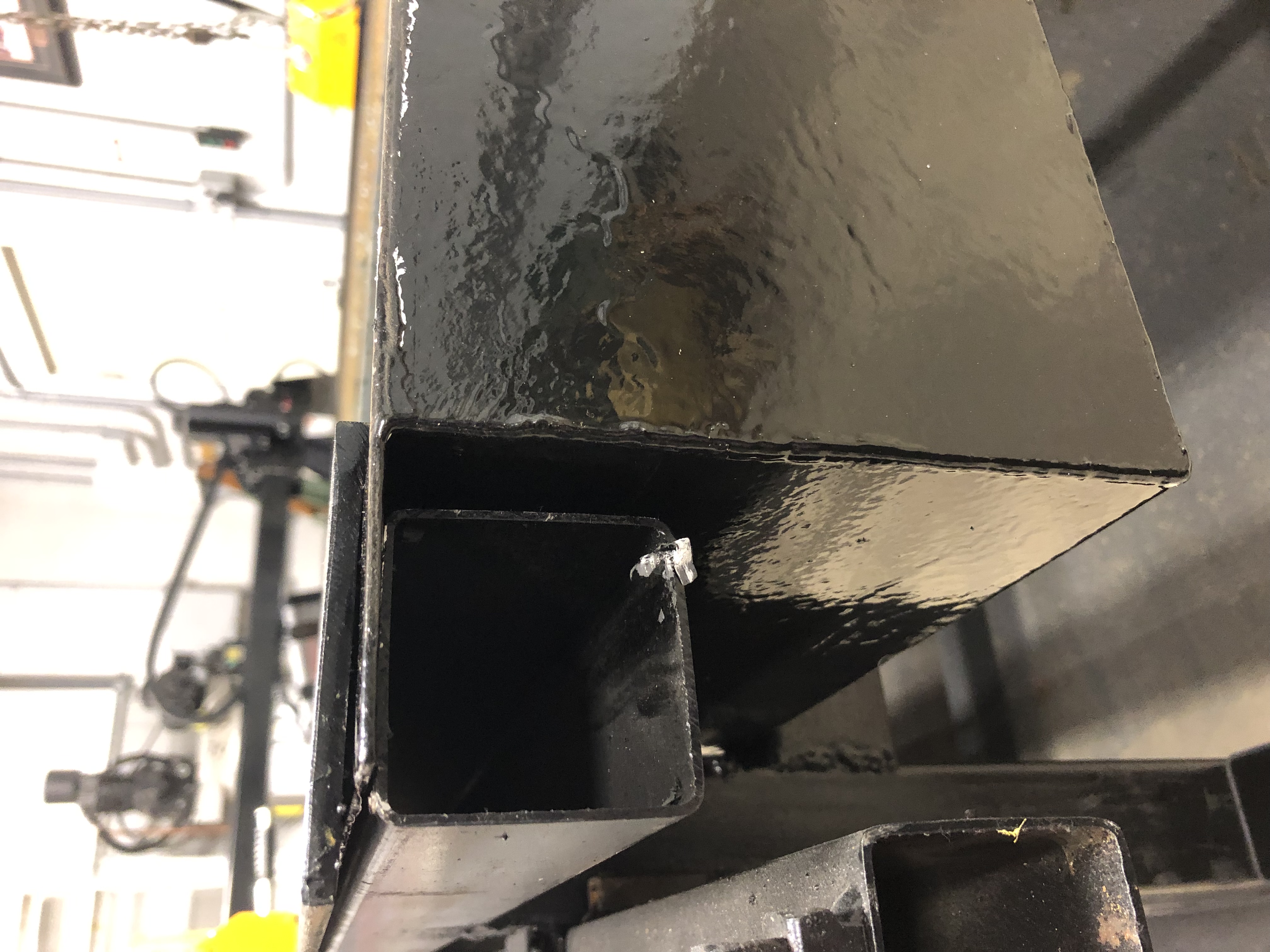

Did mine pretty much the same way but hemmed the ends and bent the metal at the sides to rest on the bottom structure and ‘sandwich ‘ it between the structure and the table.[/attachment]

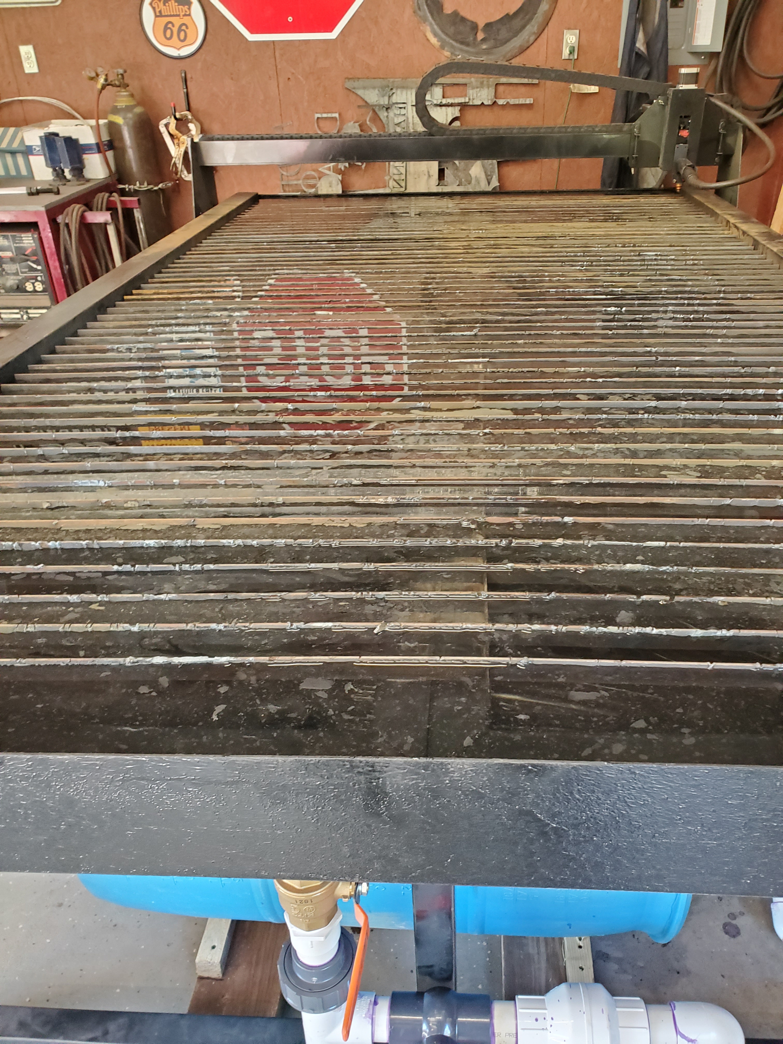

Diamondback wrote: Sat Dec 08, 2018 1:12 am Filled up with 230 gallons and ready to cut...
Table solution (per 75 gallons)
1/4lb Sodium Nitrite
1 Teaspoon Physan 20
1oz. Green Food Dye
Do you know how do you maintain the proper balance of chemicals? What do you check, Ph, or what? What do you add to adjust?
Thanks!
Diamondback
Posts: 50
Joined: Fri Jul 06, 2018 12:35 pm
Location: Confederate States of America
Re: Water Pans?
Post by Diamondback » Thu Jan 24, 2019 2:33 am
I do not, I'm just winging it for now. It would probably be a good idea to pick up some test strips and check, just not sure where the ph level should be, maybe I could use the Greencut specs (9-10) as a baseline? Because of the low cost I figured I could just change it out as often as needed, so far I've just added tap water to make up for evaporation loss and it works GREAT! My shop is clean and dust free and my table works great with the fluid level at about 1/2" - 3/8" below the steel.

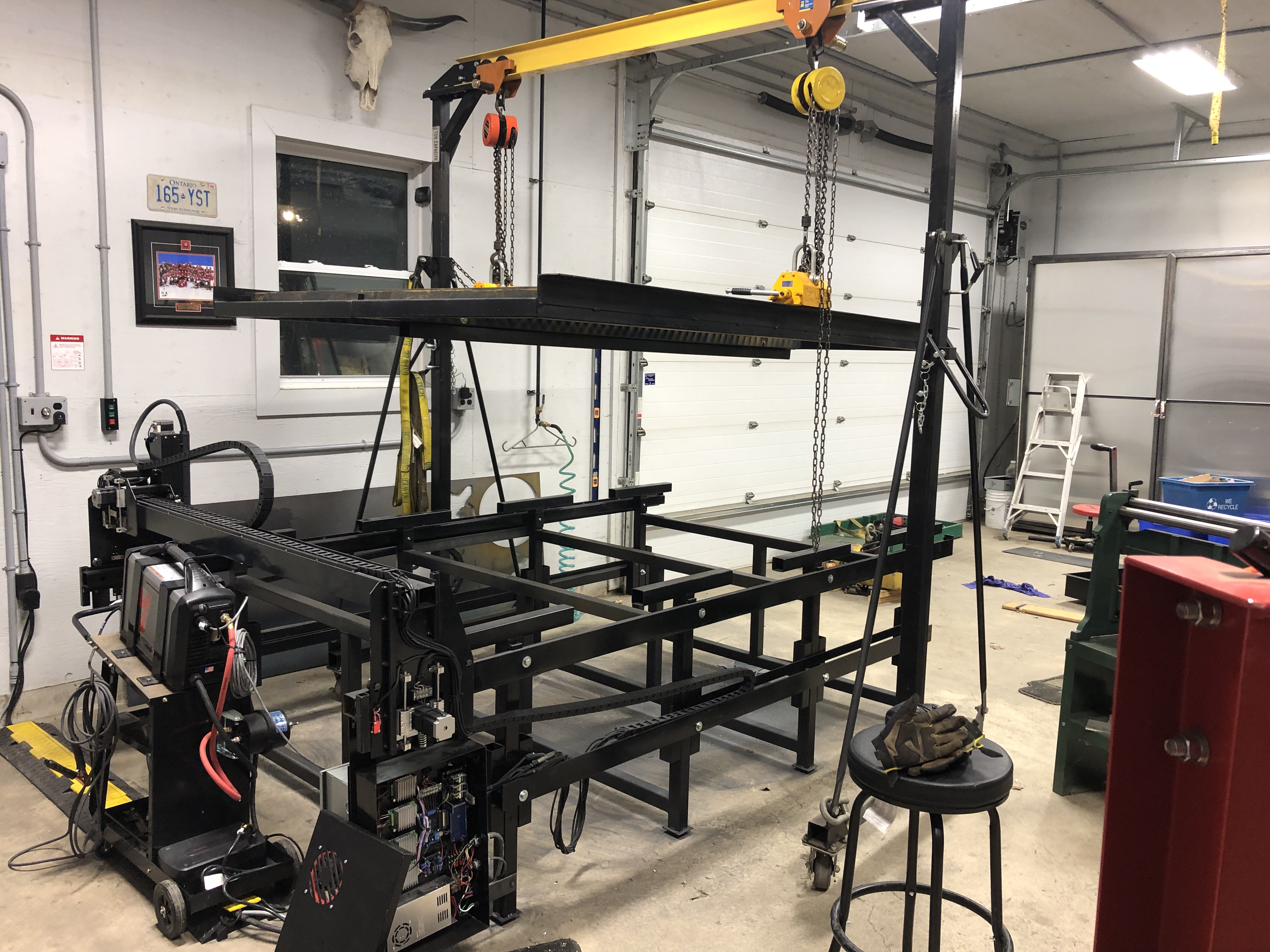

I finally finished my water pan. I couldn't deal with the dust any longer. I still haven't decided what additive that i will add to the water to prevent rust.
